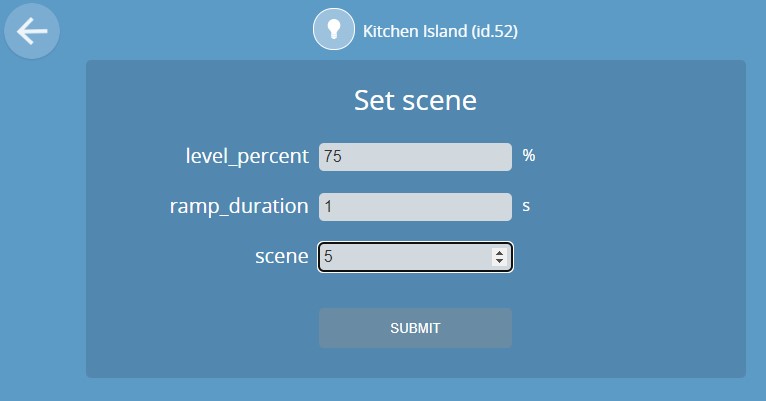

Set a scene level: Image

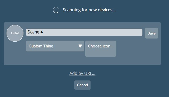

If this is a new scene number, Scan for Devices to see the scene appear and allow name to be set: Image
