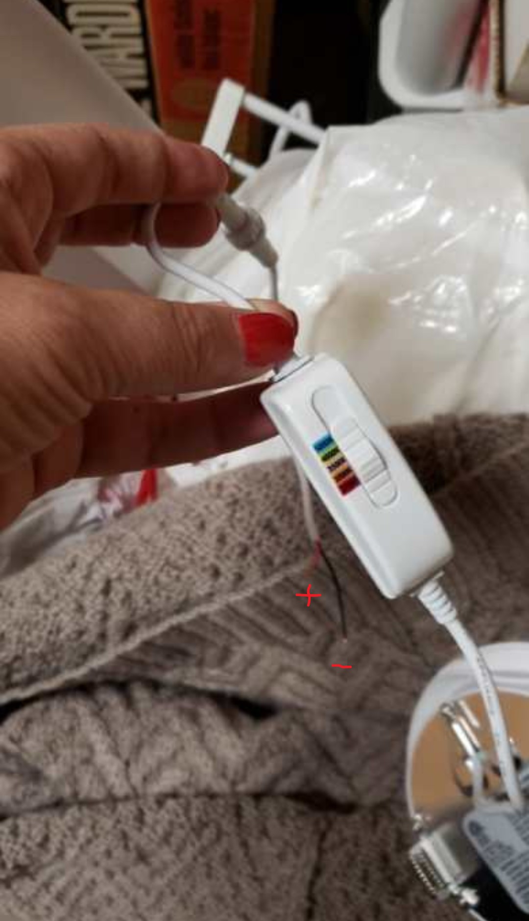

We tested 5 remote driver contractor grade fixtures from Lowes and Home Depot. All worked perfectly with LumenCache after cutting off the AC driver and connecting a SIB. This included two tunable white fixtures. They have the little selector switch (see photo--btw, not my fingernails) so yuo select the color during installation to match the other fixtures in the ceiling. When we release the tunable SIB and L3- drivers you can adjust dynamically. The wiring stays the same.
